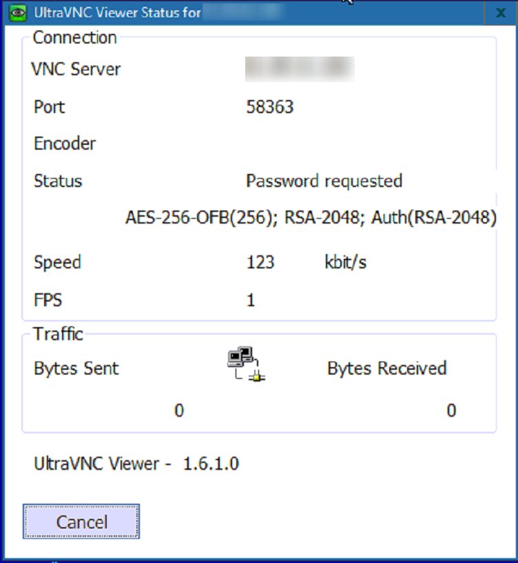

Re: UltraVNC 1.6.1.0 and UltraVNC SC 1.6.1.0 - Feedbacks
Hi @Rudi De Vos,
I tried ultravnc_sc_1610.zip with dsm plugin and custom
SC_Server_ClientAuth.pubkey
but connecting to viewer I got status window (see bellow) asking for password? It should not ask for any password, or is there some sc option to specify one?
Another bug - vncviewer.exe, when you start "listen" mode via tab "Listen" in options dialog, custom listen port is ignored, defaults to 5500.
when running viewer from commandline -listen 5590 custom port works ok.
Thank you.
Thank you.

@Rudi De Vos: I just updated from 1.5.0.1-dev to 1.6.1.0.
This new version feels quite smoother than the previous version, but I can't make the SecureVNCPlugin work in reverse connection.
The same config files will work fine in 1.5.0.1 and fail in 1.6.1.0.
VNCViewer throws this error: SecureVNCPlugin Authentication Failed (No plugin interface available)
EDIT: I haven't been able to compile it yet (as Visual Studio is not finding zlib) but it's probably related to this commit:
https://github.com/ultravnc/UltraVNC/co ... e21c6a2853
EDIT2: I can confirm that uncommenting that line fixes the Viewer side (and it works with a UltraVNC Server 1.5.0.1-dev), although it seems there's also a problem with UltraVNC Server 1.6.1.0. It stays for a while in "Password requested" and then it fails to authenticate after a few seconds.
No password is configured in this server, as it's meant to only be used in reverse connections.
