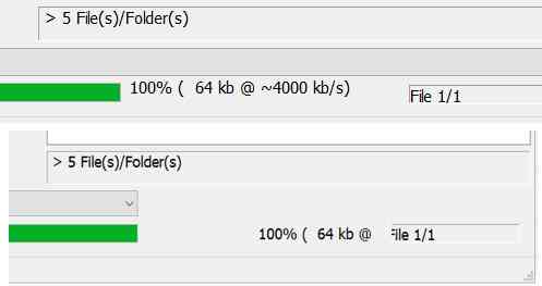

@Rudi De Vos: In 1.6.1.0:
If you try to resize the File transfer window, then:
The Progress info test was reduced and partially hidden:
The same thing happens if you simply drag the File Transfer window onto a second monitor, which has a different display scale (I have 100% and 150%, Windows 10)
Normal and after resize:

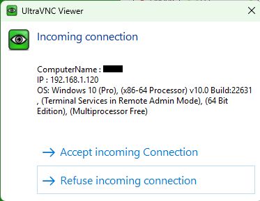

@Rudi De Vos: Hi,
Since 1.6.0.0 while using UltraVNC Viewer in listen mode such annoying window appears.
In options I have selected Auto accept incoming but since 1.6.0.0 it is not working - in 1.4.3.6 it works and no confirmation is required.
How can I turn off this confirmation window?

@wojtek: "AutoAcceptIncoming = 1" is still the correct parameter, just tested.
This can be set via Viewer -> Options -> Security
Server need to be SC or a full server started with -sc_prompt and the viewer need to have "AutoAcceptIncoming = 1" set to show this box
