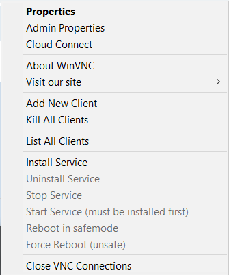

The menu has a new entry "Cloud connect"

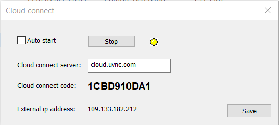

Cloud connect windows
The viewer also has the new option "Cloud"
The server code is calculated.
Both server and viewer need to reffer to the same cloud server.
To connect, enter the server code on the viser site.
led (orange) = cloud server found
led (green) = viewer and server found each other, viewer can press connect

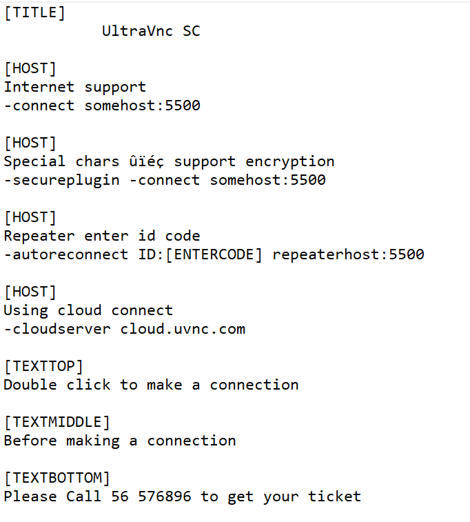

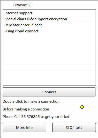

UltraVNC SC
UltraVNC SC now use the same code as UltraVNC.
Both plugin and ddengine dll's are buildin, no need for the extern dll's.
Helpdesk.txt has been modified, see sample for each type of connection

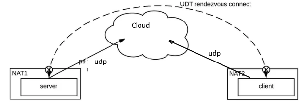

What is difference between repeater and cloud server and how it works? code is manage from cloud server? users will use personal cloud server?

Difference is that a cloud server is only used to initiate a session (a few 32-bit packets)
reapetaer -> tcp
cloud -> udp
A cloud server can easy serve a few 1000 connections while a repeater is limited to his bandwidth.
There wil be a cloud server you can host, current cloud.uvnc.com can be used to test.
There is some drawback.
In the current implementation the cloud component act as a udp layer, it's slower then direct tcp.
The natrouter need to support the direct udp rendezvous protocol.
When a server is announced he is visble for 60s and the server announce himself every 60s.
This mean that the server will still show as online for 60s after you close it.

Hi Rudy, I'm doing some tests with the new version you are developing.
this happens on some PCs
cloud connect code = 0000000000
question1 = in the final version will the cloud code always remain the same?
question2 = you will be able to create your own private cloud.connect.serer server
request:
it would be possible to pass the code to a windows variable so that with an external batch I can then view it in my app ....
Thank you
RudiDeVos
Posts: 7051
Joined: 2004-04-23 10:21
Re: UltraVNC 1.3.9-dev1 - Feedback
Post by RudiDeVos »
cloud connect code: it just some numbers from the mac address, as long as your netywork card stay the same the number is the same.
0000000000 -> looks like the function used to extract the mac fail
own server: yes
Code:
-some copy/paste function is needed
-variable, should be possible, good idea

hi Rudy, sorry for my english
for the cloud code I noticed that if the pc has two network cards (a lan and a wifi usb) winvnc always returns cloud code 0000000
Tested on two PCs and the result is the same.
If the pc has only one physical and one virtual LAN for vpn connections, there are no problems.
hope this will help for development.
