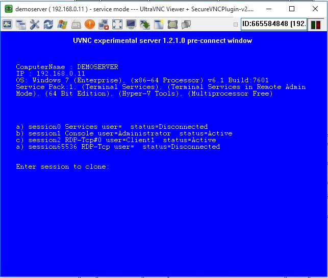

As there are more and more people asking to be able to clone a service or real RDP instead of the console some piece of code was added.
The biggest challenge is adding it and to stay compatible with the current viewers.
We added a pseudo server...some bitmap that act as desktop.
( I only can draw text / rect and have a single char as input.... but this does the trick for preselecting a session)
On connection you first connect to a pseudo server, this give a 640x480 display, show sessions and request to select
a session a) b) c) etc...
After you make a selection sample (b) the server is closed and restarted in the requested session(1).
You need to close winvcnc via trayicon or switch user to put the service back in pre-connect mode.
normal session0 should be invisible this is the service session and can not be used for vnc.
For testing purpose , to have a selection in case you don't have RDP we show it.
For release, we also need to check if you have an RDP AND console, else the whole pre-connect need to be disabled as
it doesn't make sense to show a window with a single choice.

Hi rudi,
i have done some test on windows 2008 with Terminal Server
after install winvnc as service i can see this preselection screen (in direct mode and in reverse mode)
i can connect to session1 in console (letter b) but i'm unable to connect to rdp Sesson2 (letter c)
if i press letter c for session 2 (rpd session2 RDP-TCP#0 active of client1 user) connection drops for 10-20 secs and reconnect on this preselect screen.
i put here winvnc log if it can be helpful
http://www.tecnopc.info/imgforum/winvnc.log
regard
SainSuper

Hi Rudi,
i have done other test.
Now i can connect to rdp session but only if console session is active. if console session is disconnect (console is on login screen) i'm unable to connect to rdp session client active.
When i connect to rdp session, remote control is very slow compared to console session.
sometime only on rdp session i see screen like this:

I don't know what to enter. There's a bug regarding the choices, see:

LOL
session1 =b
session2=c
session 82=acsii a +82
So i can't use the session nummer +ascii a, need to find something else.
Never thought sessions would be higher then 25
Just wondering,
how does the console session become 82, long time no boot.
http://www.uvnc.eu/download/1210/winvnc_RDPtest4.zip
Possible connections are enumerated, the session nummer isn't used for the indication.
session82 would be b) in this case

The problem is indeed that we sometimes don't know what window ( preconnect/desktop) need to be started.
Current logic
1)-We alway start a preconnect unless the connection is initiated with a keypress.
2)-When a viewer close/disconnect, the server is also restarted in preconnect.
You have
a) console session3
b) rdp session 2
After you press a) you connect to the logon window in session3, but after entering the user/passwd the console
continue by opening a desktop in session1.
A session switch cause the server to restart and a server started " not initiated with a keypress" give a preconnect.
Adding a 3the rule will already fix this for ( remote managment rdp sessions)
3)-When there exist only one active session and this is the console session don't show the preconnect
Some things are easy for human, but to translate it in rules is harder.

Rudi De Vos wrote:The problem is indeed that we sometimes don't know what window ( preconnect/desktop) need to be started.
Nice, this also solves my future feature request of showing preconnect window only if necessary. Not necessary means behave like a "normal" winvnc. You should definitely implement this rule.
But imagine you have 3 session:
console session inactive
RDP session user Mary active
RDP session user Peter active
In this scenario I want to log into console with user Mary. Windows Logon into Mary -> RDP for Mary is dropped -> VNC is dropped -> Reconnect VNC.
With the above 3 rules, will I see really directly the Desktop of console session with user Mary? Following your explanation and the given info I would expect to see again the preconnect windows with
console session user Mary (<- maybe active?)
And this would be also not intended behaviour....

Correct, but in case of 2 active sessions there is no simple rule.
In that case you need to pass the preconnect 2 x
preconnect -> console logon->preconnect -> console desktop.
When making the rules to complex you always have something wrong, with 2 active session you need to take the previous
connections in account, remember and reuse that state...to many options and exceptions.
We now have
rdmode = 0
Always console
rdmode = 1
works correct for rdp, and console with single active session ( like rdp in remote support mode)
rdp servers
rdp connections ok ( single session)
rdp server console 2x preconnect : Cloning the console when the console login and console desktop have a different session
This is acceptable, it just need to be commented so we don't get 100 forum messages about it.

Simplified, which of both assumtions is correct:
a) As long 2 or more RDP sessions are active I'm not able login to console?
b) As long 2 or more RDP sessions are active I have to do following to login to console:
1. choose console from preconnect
2. login with windows logon
3. choose console from preconnect again (which is now logged in)

b) is correct

b) is really acceptable as long rule no. 3 will be implemented ;)

done, rule 3 added
If anyRDPsessionActive -> show preconnect, else connect direct to the console session.
On a real rdp server there is a new issue.
The server running in a console session doesn't restart himself when an rdp session become active.
The server running in preconnect doesn't restart in the console when the rdp become inactive.
Service need to monitor the sessions and restart the vnc server when the sesion status change... but current
the service doesn't know if a connection is active. You can't break a viewer/server connection because the session
status change.
Possible for a next update, this require a lot of testing and i need to get something finished before 15 jan.
