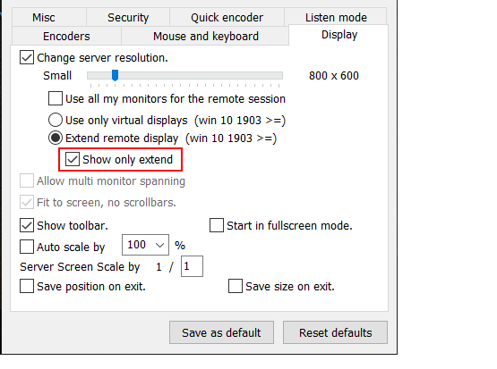

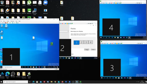

Re: 1.3.0 Alpha online
Updates:
You can open as many viewrs as you like and each open his extended display.
A lot of code needed to change one single capture for all screens and only send the relevant part to the corresponding viewer...while now all changes always reflect to all viewers.
The more code you change the higher the risk of introducing bugs.
Update server and viewer is needed, Protocol changed !!!!!!!!!!!!
Recorded a little video , adding 3 extended viewers "show only extend mode"
1) is a Hyper-v server
https://www.uvnc.eu/download/130/virtual2.mp4

It seems that now I can see more screens, but something seems wrong with the mouse after Clicking on the Select Full Desktop.
It isn't correctly positioning and start flickering like crazy..
Performance wise seems slower I think.. But I will run more tests again in 2h more or less, I will keep you posted.
Thanks for the new version.

Confirmed, the mouse is not working when Selecting Full desktop *4 monitors in my case
EXIO wrote:Hellos,

Mouse:
Extend pc with laptop screen.
Are you using the laptop or server mouse to test ?
In extended mode most people are going the laptop just as screen, this need to work in fullscreen mode.
Does the viewer need to be able to controle the server pc in this case ? Possible single extend only == view only
I also noticed the mouse behaving strange, but suspected that Hyper-v and the viewers were fighting for the mouse.
